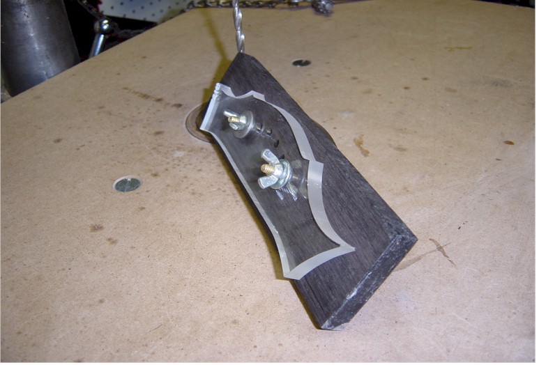

1/4" plexi. If your making smaller templates, (bridge, fingerbd. headstock,etc.), I make a template from masonary bd. Then with double sided tape, I stick a rough cut piece of Plexi cut about an 1/8" larger on the band saw, to the template, and pattern route it on the router table. clean up the cut sides with sandpaper down to steele wool, buff, and you have a factory looking template. I use 3/8" for router bases. (see pic).Here's just a few templates I have.

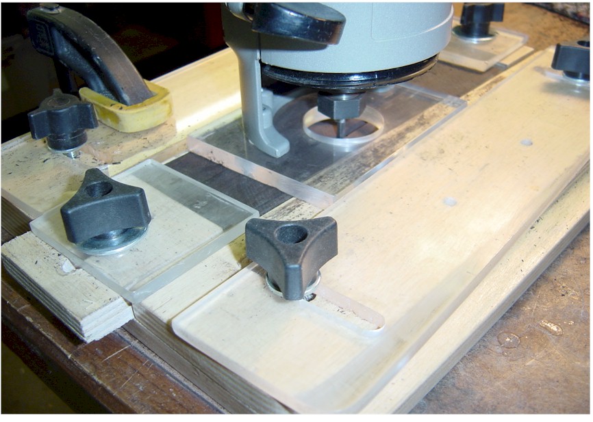

I have made many templates from Plexiglass and have always found that routing works best. I follow the same practice as Mark and make a template from masonite and then use it as a routing pattern template for the plexiglass. I also recently started experimenting with flame polishing the edges using a propane torch which produces a nice clear edge and works especially well on plexiglass fixtures (not all that great for templates).
